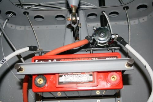

Brief Description:  Finished up wiring the battery box area

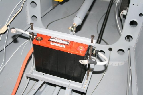

-Finished up wiring the battery box area by doing the following:
Created and mounted the battery positive lead to the batt contactor
Created and mounted the battery negative lead to ground (in this case the battery box itself using one of the #6 nutplates (1/4 bolt).
Created and connected the hot battery bus wire that runs from the battery side of the battery contactor to the hot batt bus fuse panel
Connected the wire that runs from the batt switch to the batt contactor
Here you can see the contactor is alll wired up and ready to go.
