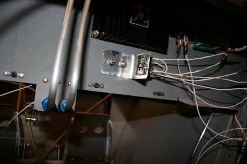

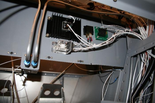

Brief Description:  Relay fun #2
More wiring of the relays and stuff.
-Crimped on all the connectors for the smoke relay, e trim relay, flap relay, and bridge rectifier for the ebus. Also I ran the flap motor wires. All this stuff resides just fwd of the right gear tower on the bulkhead that separates the baggage compartment from the cockpit.
-I then fabricated a bracket to hold the e trim relay (radio shack dpdt). Turned out pretty nice. I drilled the holes and installed with #8 screws
-Then I connected all of the wires.

e trim relay bracket with base installed and wired.
All this stuff lives behind and under the instrument panel.
