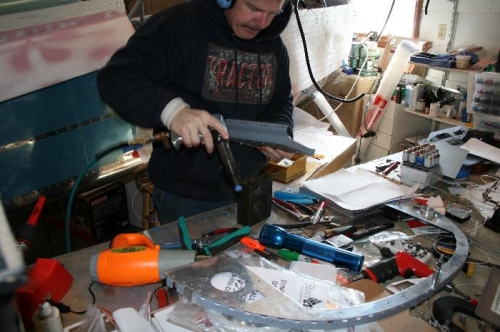

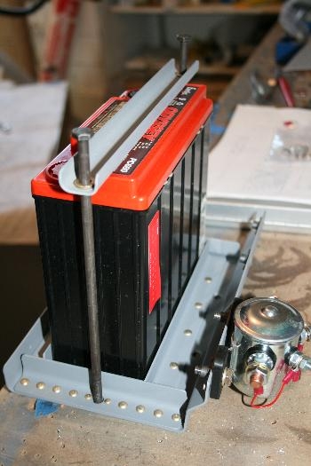

-Worked on modifying the aft mount battery tray to accept the small, lighter Odessey battery. I did this by riveting an aluminum angle behind the battery and putting one in front that attaches with the already present attach screws. I primed and riveted the parts.
-Mounted the battery relay to the tray

Doing some good ole fashion riveting - I miss it sometimes!
Battery tray ready to install
