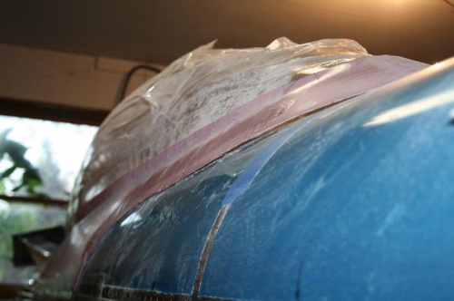

Mild success with the prop laying against the skirt. I'm down to 1/8" at the widest point (gap between the fuselage and the skirt). In thinking about this I need to get this skirt final trimmed and mounted to show how the shape is riveted vs cleco'd and yes there is likely a difference based on clamping pressure etc. I feel certain I can correct these gaps in the final finishing of the canopy assembly.

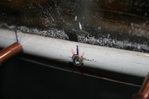

-Used a small dremel ball grinder attachment to grind the mandels down on the blind rivets that had them sticking up.
-Drilled out the blind rivets. I must have gotten a steel rivet mixed in and that one basically got very hot and spun through the hole. Luckily there were no damage other than a large hole which I prefer anyway.

Here's the 1/8
Here's the 1/8" gap that I'm fighting with.
Here's the steel rivet that essently melted through the plexi - scarey indeed.
