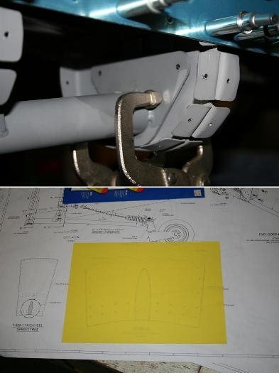

-Made shims for the tail wheel mount per the plans. I cut them out of fuel tank inspection covers that I didn't use (thick stuff).
-Clamped the tail wheel mount (WD409) to the F811 bulkhead and match drilled it using the holes in F811 as a guide.

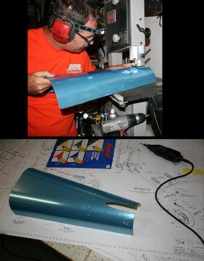

-Made a template of the cutout required for F828 aft bottom skin to accomodate the WD409 tail wheel mount. Used tracing paper and it worked pretty good. Rough cut with the bandsaw and then used the demel with my favorite metal removing tip and then filed and sanded with emery. Fit good!

Top pic - tailwheel mount drilled. Lower pic - tracing the bottom skin tailwheel mount relief.
Rough cutting the relief with the band saw - check out the dorky headlight! Works great though.
