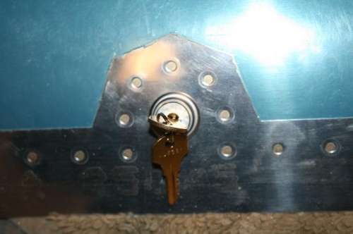

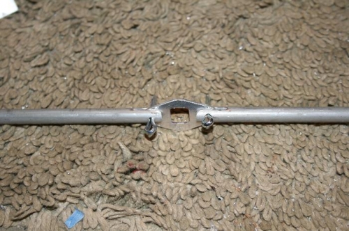

-Went to the hardware store but all the locks were the same or bigger so I'm committed to try this one before ordering one from Vans. Had to fabricate another cam that goes on the end of the lock as the Vans supplied one had too big of a hole in the center (square hole for the lock mechanism)
-Did some work on the engagement pins to accept the slightly thicker new cam.

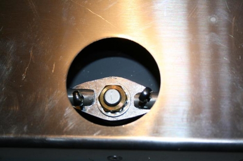

-Relieved the opening in the door skin very slightly to allow the body of the lock to fit through
-Temporarily installed everything and it seems to work as advertised!
Engagement pins hooked to the came with cotter pins
Lock temporarily installed
Temporarily installed to test the action - works good!
