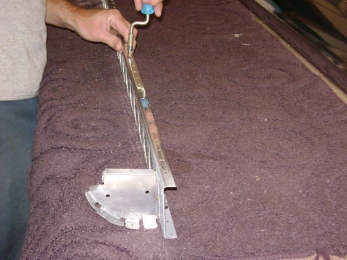

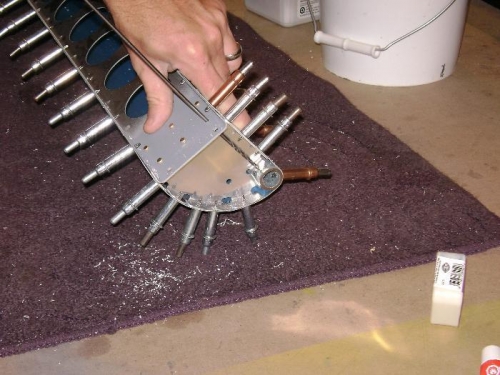

Worked on match drilling the counter balance weight Left Aileron(steel pipe galvanized). I also deburred all the left aileron parts (skin, skeleton, ribs). I still need to countersink the counterbalance and dimple everything. Then it's prime and reassembly.
Drilling the counterweight to nose rib hole with a long 1/8 bit.
