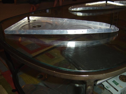

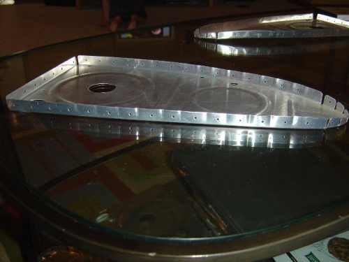

Brought my working into the living room. Worked on fluting the ribs for the fuel tanks. I used our glass coffee table top to check for flatness. I generally squeeze the flutes deeper in the area where the rib is bowed (or high) and it pushes it down. Not a great description. It's a trial and error process at best.
Before
Before
After
After
