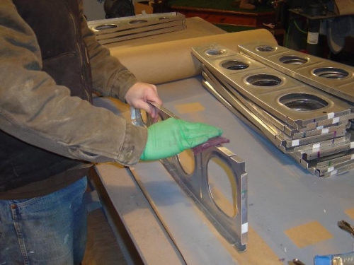

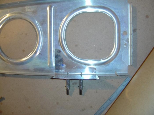

Up early this morning again before work. I scuffed the flanges on all the main ribs as it is much easier to do this before fluting. Also worked out a jig to drill out the holes in all the main ribs for the wiring conduit per the Vans FAQ recommendation. More on this next session.
Scuffing the rib flanges with a maroon scotchbrite pad
The crossed lines denotes where the 3/4
The crossed lines denotes where the 3/4" hole will be drilled. Note the drill jig is cleco'd on.
