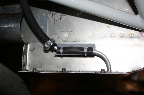

-Installed the fuel pump overflow drain per the plans except I didn't use the junky copper fitting on the pump with plastic line. I used an AN fitting and reinforced rubber hose. The exit part of the install was per plans.

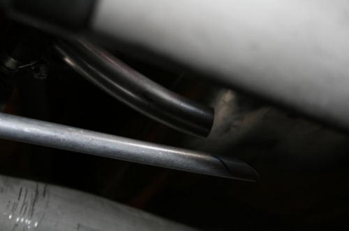

-Figured out my routing for the sniffle valve. I put a short rubber hose on the nipple and then ran an aluminum line (thick walled) back to the air outlet. It will adel clamp to the oil vent exit line.
Fuel pump overflow exit pieces and parts.
Sniffle valve in place temporarily. I plan to put a heat shield on the exhaust and firesleeve the vent
Sniffle valve line exit is the smaller one. The oil crankcase vent it the top one
