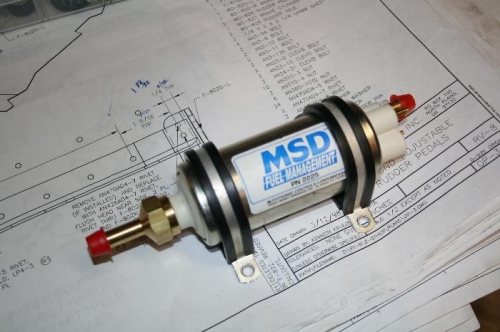

Here's the fuel pump that will do the job of moving the smoke oil
