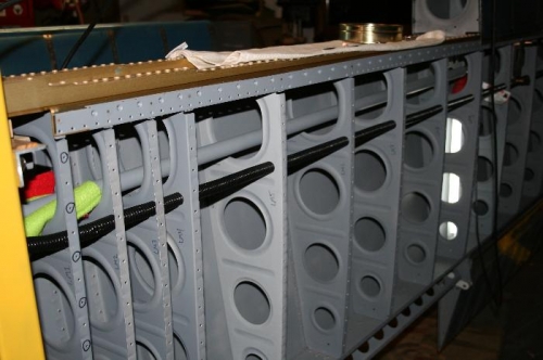

This morning I worked on the aileron actuation. I put the rod ends on the pushrod tubes and adjusted them loosely to the correct lenght per the plans. I fabricated the spacers for the push rods and the aileron pushrod attach. I then Attached the control stick-to-bellcrank pushrod to the bellcrank and then then the bellcrank-to-aileron pushrod was attached. Everything is going to gether pretty smooth. I need to do the right side next. That will be alot fast as I have all the parts ready and it's just a matter of assembly. Once that is done, I will remount the fuel tanks and then switch gears back to the pitot tube mounting assembly.
Here's the long pushrod tube that goes out the bellcrank.

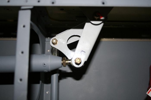

Here is the same pushrod attached to the bellcrank, note the smaller rod going down to the aileron

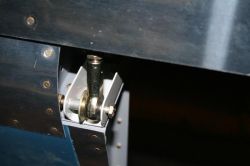

Here is that small pushrod again at the aileron attach point.
