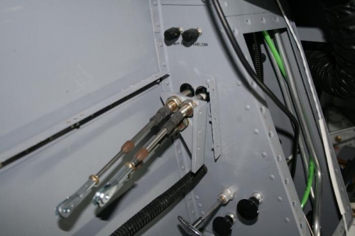

Brief Description:  Engine control rigging
-Embarked on the task of rigging the throttle, mixture, and prop controls - not an easy task. Confined work space, one adjustment throws everything off and any adjustment, at the quadrant anyway, requires you to dissassble the whole mess - not fun. I must have had the quadrant on and off 3 dozen times. I must be dense, but I can't see any other way to do it - trial and error.
I had to open up the gear tower holes as it was binding using the method called out in the plans.
I  spent way too much time with these 3 cables

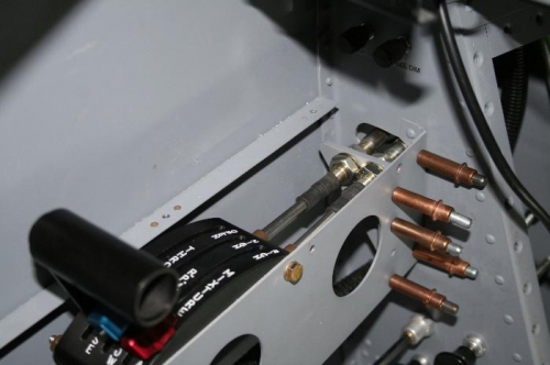

Here's how it looks connected
