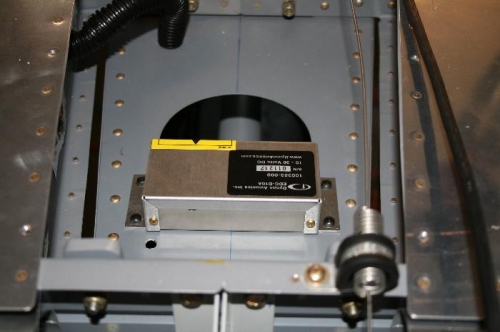

-I started working on the dynon harness I purchased from a fellow on VAF
-I decided to locate the dynon remote compass on the aft deck, others have not had issues having it there. The elevator horn may cause issues, but I can move it fwd if it's an issue.
-Had to remove the vertical stab to get to the deck. I also had to move the aft position light wire as it would have been too close to the compass. That was a pain to get it out of the conduit - long story.
-Also put an adel clamp on the ELT antenna.
-Measured the compass for square and marked the holes, drilled and deburred them.
-I then routed the shielded cable for the compass back from the instrument panel to the aft deck.

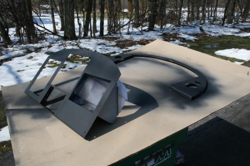

I then switched gears and experimented with painting my instrument panel. I primed it with 7220 and then put Rustoleum black primer on to see how it looked - we'll see. I like it so far.

Dynon remote compass
Panel paint -1st iteration. Note the snow - this was the 1st 50F day in months
