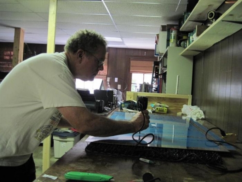

The last several days I have been preparing to build the right tank again, but before I can do that I need to get the left wing skeleton to the point where I can take it out of the frame and place the right wink skeleton back in the frame. I messed up building the frame and can't work on both wings at the same time, too close together. So, I need to get all the holes deburred and dimpled, and there are a lot of holes in the wing skeleton and skin.

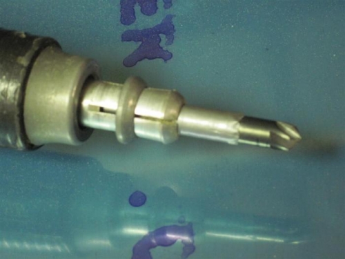

I found the battery powered electric drill getting real heavy after deburring a couple of hundred holes, found the air drill too difficult to hold at a steady speed, and found my fingers getting sore if I just spun the countersink bit with my finger and thumb, although that does a good job. I then got a brainstorm; back in my other life when engineering drawings were done on paper with pen and ink, before drawing on a computer (CAD) became the norm, I used a device called an electric eraser, which spun cylindrical rubber erasers that I remembered being about 1/4 inch in diameter. I still had one that had not been used in over 15 years or so, so I dug it out, and the chuck just fit the 1/4" shank on the countersink bit. It worked like a charm, light enought to use for a long while without getting too heavy, and a switch that operated by just pressing with a finger. After a while, the chuck began slipping on the smooth shank, so I wrapped a little duct tape on the shank and that problem went away.
Got a lot of holes deburred, still have a couple of hundred to go, then for the dimpling.

Closeup of the friction chuck and deburring tool (countersink).
The eraser serving as a deburring tool
