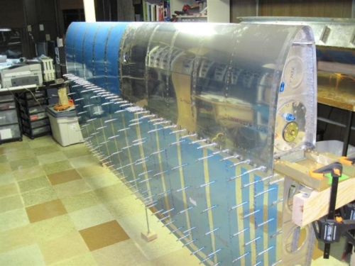

On Friday the 16th, I checked to see if I could find where the miniscule leak was coming from. When I put a little soapy water on the tube supplying air through the vent line, saw some small bubbles coming from between the neoprene tube and the aluminum tube. Patched that with some duct tape, and that appeared to do the trick. Left the tank for 3 days, and it lost about 1.5" of head, that's good enough for me. Took the test off and put the tank on the left wing in the stand, and it fit perfectly.

The new left tank on the wing where it belongs.
