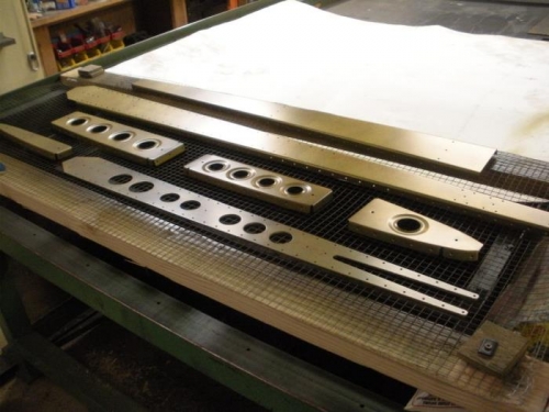

Date:  1-21-2019
Number of Hours:  2.50
Brief Description:  Parts priming
Cut the counter sinks into the VS808 doubler to match the dimples in the rear spar. The de-burred edges and holes.
Mixed up a batch of Sherman Williams wash primer and sprayed all internal parts of the VS.
NOTE: I am not doing any priming of the inside of skins. All skins are of "Alclad" aluminum which does not require priming. I'm doing this to save weight.
