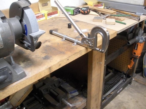

Set up my squeezer. I find it easiest to use by mounting it to a workbench. Dimpled all the #40 holes in the ribs and spars. Then, used the C-frame to dimple the #30 holes in the rear spar as per the plans.
