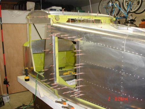

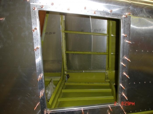

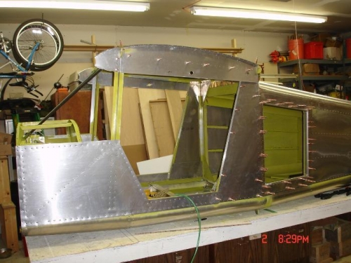

Placed PF-226 on left side and drilled for rivets and clecoed in place. Placed skin PF-226 on right side and drilled and clecoed in place. Marked for cargo door and cut out and drilled for rivets in out side cargo door frame. The cargo door sure make for a nice loading and gives easy access to the cargo area.
Cargo space
Cargo space
Cabin and cargo door
