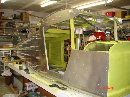

Brief Description:  Attaching cabin to fuselage and side skins

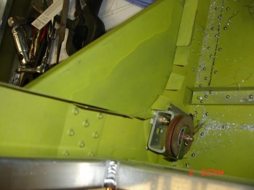

Before you attach fuselage and cabin together make sure the bottom of the fuselage is tight to the bottom of the cabin. Everything lined up but I had to make the cuts on the bottom skin corners as per the drawings so the fuselage would set tight to the bottom. I installed 414 rivets every 50mm up the sides and through the webbing in the back of the cabin. This is just to hold the cabin and fuselage together. The skin is what gives the strength to the joining of the two. Cut out float attachments slots and installed PF-188 PF-202 & PF-203 on both sides. Riveted double row of 410 rivets on bottom of cabin and fuselage.
