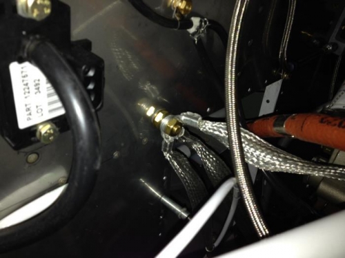

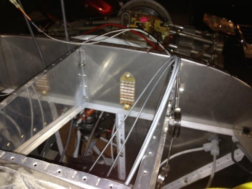

Purchased 3 ground braids from B&C. They are 2 AWG equivalents. Two go from the thru bolt of the FOT ground point to the engine block. The other one ties the thru bolt to the negative battery terminal. I had fabricated a 2 AWG wire for the battery lead, but the braid is more flexible and easier to work with with the engine already mounted. (This entry written 7/17/2016. Date of entry matches dates on the pictures. No estimate of hours to install the braids.) Sometime after the FOT was populated with ground leads, I realized I should mounted the FOT a lot lower to reach it more easily once the final skin is on the fuse!
Braids on FOT thru bolts
FOT on cockpit side of FW
Wider view (fuzzier too) of FOT
