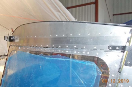

Riveted left and right door hinges to root ribs. Secured ELT antenna lead to back of left baggage area back. Found out it will be a chore to remove ELT. Installed snap vent into left door. Vent is different than photo manual and does not have a retainer spring wire.

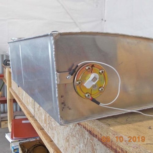

Installed fuel level sender to left fuel tank. Put plug in fuel outlet. Added 5 gal fuel and turned on inboard end for fuel leak check..Installed snap vent to right door. Removed both door.

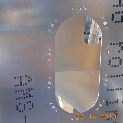

No leaks in left fuel tank after 20+ hours. Poured gas back into fuel container Added conector to fuel sender wire and stand offs to rib. Started in on drilling the 80 holes for rivets to hold the 40 nut plates for the four wing inspection holes. Got 40 done on the inboard holes of each wing.
Hinge riveted to rib
Nutplate mount holes
