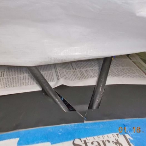

Finished glueing windshield seal with RTV silicone. Glued forward center glareshield vinyl to forward top skin with 3M Super 77 spray adhesive.
1/19/20
1.2 Hours
Masked off forward top kin then sprayed the adhesive then smoothed on the vinyal glareshield. Removed the masking materials.

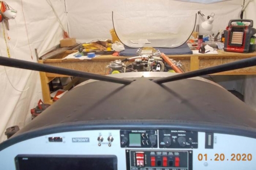

Worked to get some of the bubbles out of glareshield. Put dash seal on. Put windshield back on to check fit and screw hole alignment after seal is onl. Clecoed vertical channels in cabin
Glareshield finished
