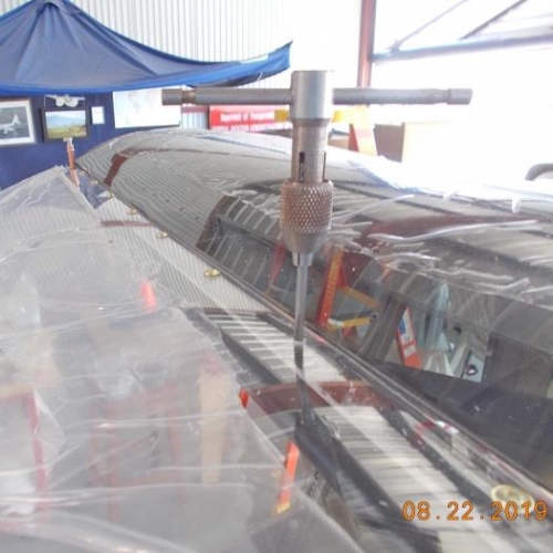

Cut two plexiglass spacer strips to length. Back drilled through top window trim into strips. Up drilled strips. Clecoedi windshield with spacer strips into place.
8/22/19
4.0 Hours
Made another spacer strip after one broke while drilling yesterday. Up drilled to #29 and tapped the ten holes in cross spar for 8-32 washhead screws. Trile fit windshield, spacers, top window trim and top window.

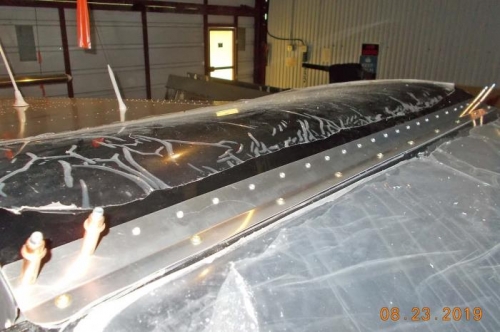

8/23/19
3.0 Hours
Screwed the aft edge of top window with the eleven new #10 washerhead screws I received from ASS. Riveted the top window trim to the top window.
Tapping top trim
Tapping top trim
Top trim riveted
Top trim riveted
