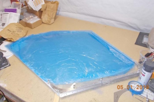

5/1/19
3.1 Hours
Drilled pilot holes in right door frame at about 80mm pitch. Placed bubble on frame. Taped a cut line on top edge and trimmed with Dremel tool to tape. Sanded cut smooth. Back drilled through the two top corner guessets and a couple spots on top tube and clecoed. Back and forth to aircraft to get fore and aft edges of bubble to fit in door jambs. Not quite there yet. Norma removed spill over paint from factory then held work light for me while I was cutting bubble.
Right door in progress
