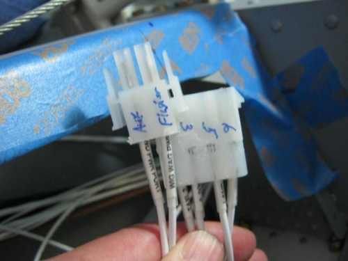

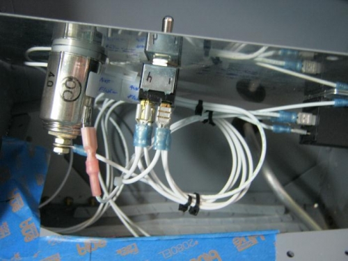

Finishe d up the wiring for wig wag and power plug on lower rt console shelf....I hope!
I cut off the spade type connectors I had installed yesterday and replaced with barrel molex pins and plugged into the shell body. I then installed the shelf with wired assemblys and plugged toggether. I had plenty of slack so I shouldnt have any trouble removing. I will clean up the wiring a little and rewrap rhe harnes of wires below but should wait until wiring is certain.
I used a test light bulb to verify power at taxi and at landing wire ends. They work But! When I flip on the wig wag They act strange. One side burns bright and the other side makes a buzzing noise from flasher unit. This what I think/hope is happening. The flasher unit contacts are on one side eg the landing light for example. In order for the flasher to operate properly it requires a load on both sides! I only had one bulb and so I need to get another cheap lamp and hook them both up to verify. Not sure what to do if thats not the problem. More later
Female barrel molex pins installed and installed in shells
put shelf with assemblies in position and plugged together
