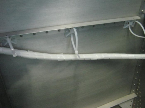

Brief Description:  bundled wire in baggage area
Bundled the wires going forward through the fwd baggage area with 3/8 inch spiral wrap.
Cleaned off the sticky bacing on 3 plastic zip tie anchor plates and glued them under an angle on outboard wall of the baggage bay with amazing goop. The wire bundle seems to be ok with out any other ties but will be more secure tied up and will look better.
Im waiting for the adhesive to dry completely befor I zip tie it up.
Wire bundle in fwd baggage area bundled
