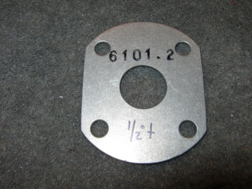

Installed just the wheel axles again to double check the toe out situation I had earlier. After Completing I verified I still had The tow out and mostly just the right side. I had purchased some shims from Vans and they came in. The single 1/2 degree shim on the right side seemed to do the trick. After reinstalling and checking as per plans, The problem seems fixed. There might be just a very slim toe out on left side but I think its splitting hairs and a .25 degree shim might be too much so Im leaving it. I have pics and they look perfect and so I wont bother to post them because I cant get the pics to show the slight gap.

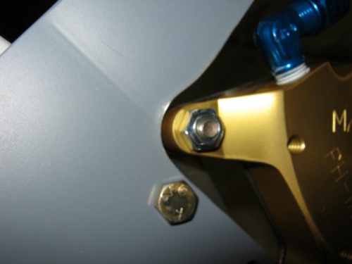

Removed the axles and began the install with brackets and wheels etc. First Issue reared its head when the brake calliper interfeared with the wheel pant bracket. This required a series of removing and grinding away material untilll I had a good fit. Painted again before install.

half degre toe shim. just the one used on right side to toe the axle out 1/2 degree
Relief made on wheel pant brackets for the Matco brake callipers

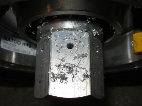

Drilled wheel axles using the wheel axle nut for guide on initial hole.
