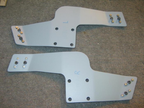

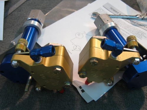

brake fittings and wheel bracket nuts
Counter sunk for flush rivits to secure 4 plate nuts to each wheel pant bracket an in the directd then installed the pale nuts per dwgs
Installed the 90 degree An fittings tohe top of each brake unit and used permatex pipe thread seal and then positioned as per the dwg.
