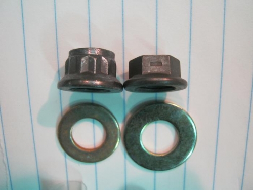

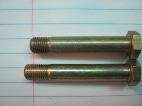

i took pics of the Vans supplied outboard gear horn attaching hardware.
The bolts are 1/8 inch longer and are to compensate for the taller nut being used. The washers are called for with this type of nut and have a smaller O.D and thus should fit in the weldment well nicer.
New nuts are also a 12 point instead of 6
