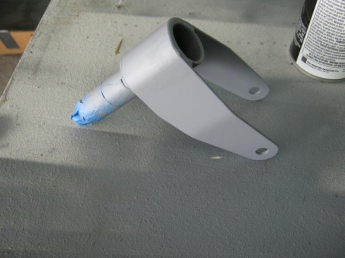

Brief Description:  Primer tail wheel fork
Removed tailwheel from the forks and then removed the fork from the stinger hub
Sanded off the surface rust and then sanded the entire piece as well as knocking the edges down.
Taped the stem off and then primered with NAPA self etching primer. 3 coats.
I will either paint this with black enamel or Ill take it in for powder coat later but for now this should prevent any more rust from just sitting in the hangar
Painted the tail wheel fork
