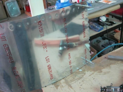

Rivitted the rest of the outer skin rivits of thge fwd baggage door. I continued to do a few and then imstall on fuse to check fit etc.

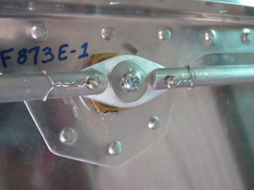

Installed the lock and latching rods. The holes in the ribs required drilling up and new snap bushing installed and enlarged slightly. The rods were safetyed as per instruction
Last of the fwd baggage door outer skin rivits  installed
Lock and latching rods installed
