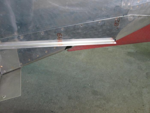

Brief Description:  Install the left and right flap fairing up stops.
The fairing for the flap to fuse were previously fit and drilled when the wings and flaps were on.
The fuse skin hole needed to be machine countersunk along and area that was double walled and then the aft area was dimpled.
With brendas help, We got the left side rivited as per drwg and half of the right side. There are a few rivits that need to be drilled out and done again.
View of left side flap fairing and up stop rivited in place
