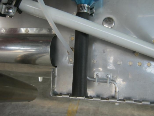

Added a length of 9/16 ID rubber hose to gascolator drain cock and secured with hose clamp.
Cut hose to just touch bottom of cowl and let hang naturally. The hose is thick enough that it will stay in position good enough.

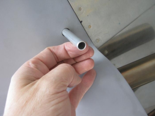

Cut a piece of 3/8" aluminum fuell line so that it was about 5 inches longer than hose and then deburred the ends. I tested the drain operation by inserting the tube inside the rubber hose and push up to activate the push release drain. It works fine. Made sure that the drain lever springs close after realeasing presure. I then turned on the fuel pump and tested for real and fuel comes out the tube as planned.

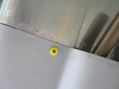

After the bottom cowl was installed, I drilled a 7/16" hole in bottom cowl where I meaured the rubber hose comes to inside cowl. Perfect! The hose can move some without being dificult to pull into position with the push tube I made. If it moves too far, I can reach up from where the bottom pins to =cowl are and move the hose fairly easy. I also found a plastic plug that fits the drilled hole.

hose clamped on to gascolator drain cock but plunger is smaller diameter and will plunge and release w
3/8 fuel line made and long enough to push up thru hose and depress the drain valve
Stow the drain rod and plug the hole
