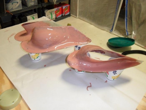

This weekend I focused on the gear intersection fairings and seat heat. The last intersection fairing to fit was the lower left, which required removal of the left wheel pant to install the necessary nut plates. While the parts were off, I added a layer of epoxy flox to the two places where the wheel pants attach to the gear bracket. This serves to reinforce the attach point, and also to level the curve of the fiberglass at the attach point to make the bracket fit better. I then removed the upper intersection fairings and after a little more trimming, applied a thick coat of micro epoxy to all of them. After curing overnight, they were ready to install and go fly…lots of sanding and priming left, but for now they will work to finish my phase 1 flight testing.

Modified intersection fairings getting a coat of epoxy
