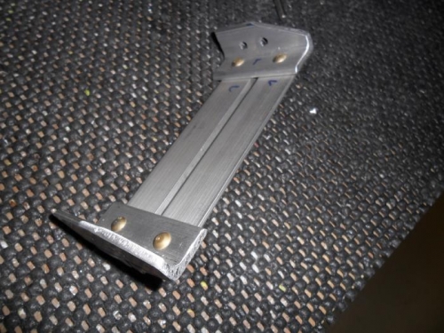

Brief Description:  Crotch strap installation
Today was mostly focused on getting the pilot-side crotch strap bracket installed so I could get the floors and rest of the interior back in place. The bracket kit I purchased from Van’s was essentially useless due to my placement of the control stick wiring, so I had a choice—move all of the wiring or make a new bracket. The crotch strap is primarily there to hold the lap belts down and in the proper position, so I elected to fabricate my own bracket out of some excess angle stock I had. Once that was finished and installed, I tested out the straps and everything fit, so I spent awhile getting the floors back in place.

Crotch strap bracket
