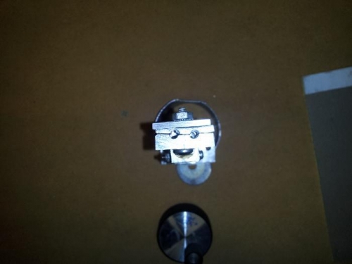

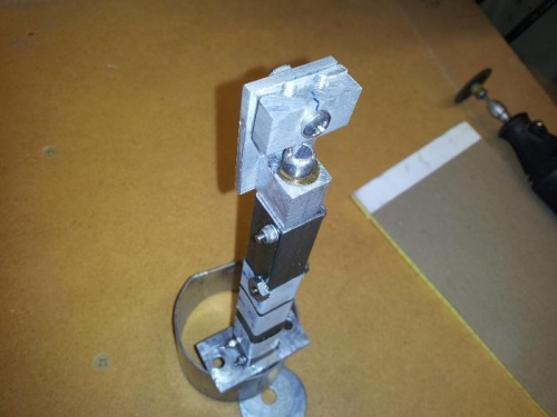

1) this is the fwd end where the bowden cables enter via the clamp.(the clamp will probably be re-made as it isnt really that good. I have drilled and taped two side by side holes into the clamp block, then cut the block in half to make the two halves. I didnt do a good job with the cutting!)
2) The end where the clamp accepts the cables

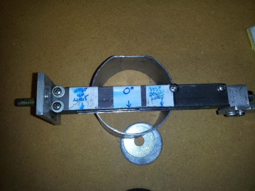

3) I installed and ran the system to check the limits at the elevator tab. I marked where full up trim, full down trim and nuetral are located for reference. I will later take actual numerical dimentions for log entry and history for the inspection routine. You can see the small hardeware used
Over length of this clone is about 6.5 inches, height approx 1.5 in at widest part. width is the mounting plate dimention, maybe 3-3.5 inches. I forgot to measure that. Weight is very noticable different that clone 1, ocupies much less space, and still retainc robust construction
so far so good!!
FWD end
FWD end
cable housing clamp
cable housing clamp
limits
limits
