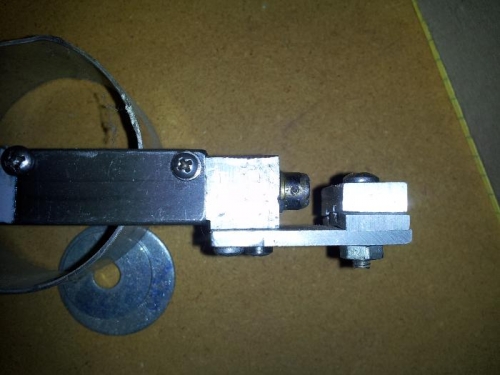

1) this basically shows the design of the machined blocks utilized for attaching the front and rear items. The threaded shaft is secured by a nut from the aircraft supply drawer, flutes turned off, and then pinned with a expandable , small pin to secure it. If there had been a SS shaft stock with a bolt head already inplace, I would have perfurred that, but could not find one without having to have one shipped in. The other end is free floating, and without the knob attached the nut/shaft assembly will move about 1/2 inches I felt I did not have enough room to secure the knob end reliably and still stay within the goals needed.
Thats it. Please bear in mind this HAS NOT FLOWN yet and is still in the 'BETA' testing arena! It may change, or I may have to revert to Sonex and buy something! But experimental is indeed just that!
Comments please? And thanks for the interest!!
