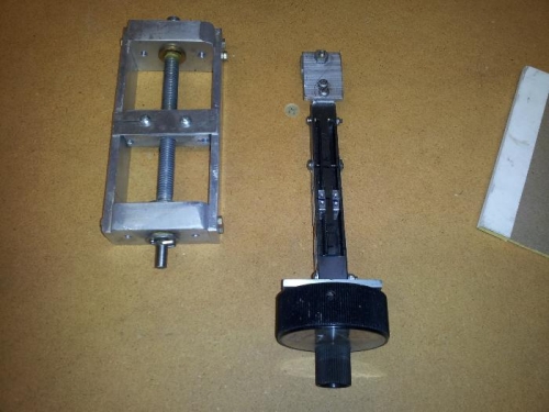

Brief Description:  comparison of 1st and 2nd systems
1) overall comparison between 1 and 2 clones. Number 2 is much smaller, and about half the weight, at least. The square tube is 4130 left over from other items constructed

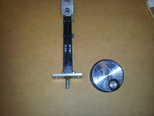

2)Showing the spinner knob made from an old radio knob and smaller knob.,And showing the cockpit end shaft

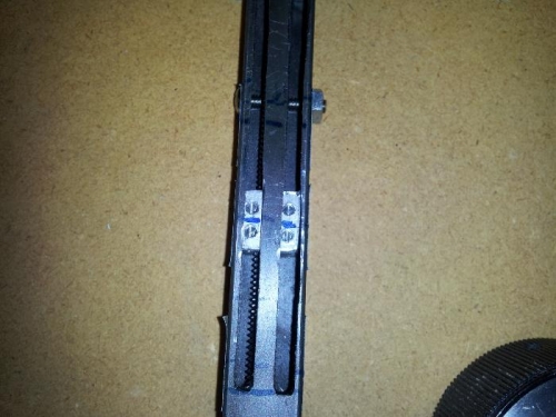

3) This is where #2 clone gets a bit different. The slider nut is inside the tube after it was cleaned out to be smoothe inside. The nut is from aluminum square stock. It has two small set screws to secure the inner wires of both bowden cables. The cable wires will also have a turned up end so as to not completely disconnect should set screws release their pressure, shich they shouild not.Lubrication is minimal and the slots (dremil tool) face down when instqalled to prevent debries from getting inside. A fabric cover may be also applied, but I have not fabricated that yet. Construction hardware is stainless with lock nuts
