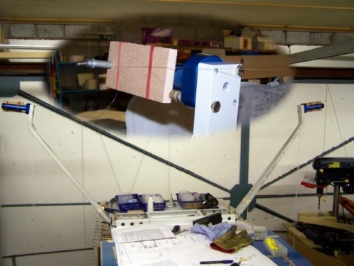

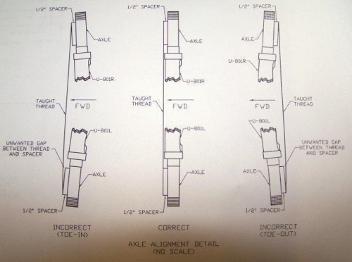

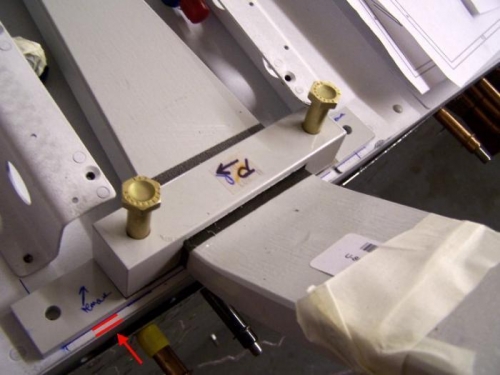

Landing Gear 2 - Drilling and Alignment
There is insufficient space on this page to detail the gear alignment and drilling so I have compiled a guide and this can be downloaded

Edge distance
Toe check - DWG 45
Toe check spacer
