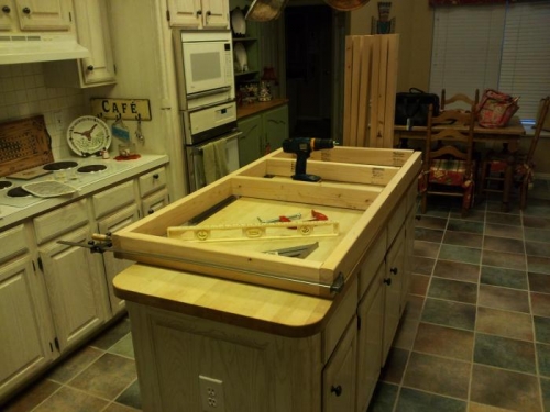

Built (mostly) two workbenches – finished them 10/13/12. Started with the standard EAA 1000 workbenches and made them a little wider (3 1/2') longer (5 1/2' on one and 6' on the other) and made them both taller for my height. The plywood top overhangs all the way around so I can clamp whenever needed.
start with a pile of wood
I needed a level surface to build the table...shhhh, don't tell the wife...

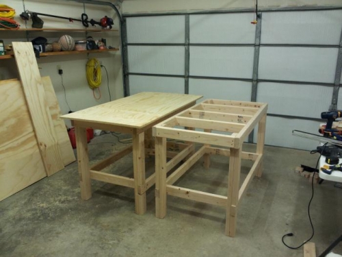

Mostly done here...added retractable wheels to both tables, shelf added - and the top of course
