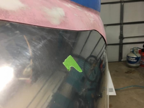

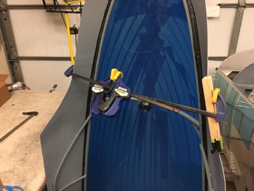

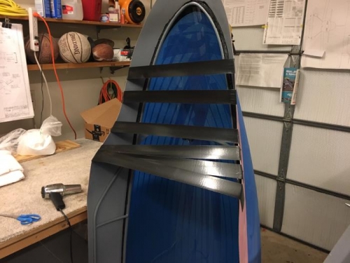

Brief Description:  Remove canopy for skirt clamping
I am trying to see if it will make a difference to remove the canopy and using tape or clamps - if I can get the canopy skirt “overbent” and heated so that it will close the gap. Many iterations of clamping, heating, cooling and re-installing later I realize that trying to bend the skirt is no longer viable. Especially on the right curve - any bending that is done just moves the gap to some other spot on the curve. I will need to remove some skirt material so that it doesn't just move the problem but removes the gap by moving the skirt closer to the fuse. Alright - I am a slow learner - but I am moving on from trying to bend my problem away.
gap moved, but still there.
