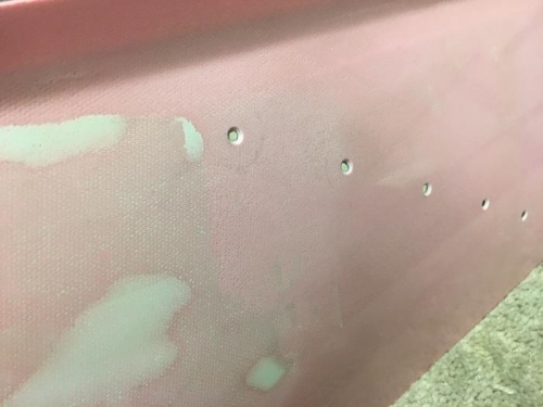

Brief Description:  CS the CS (Counter Sink the Canopy Skirt)
I also set up the countersink bit with some scrap that I cut from the skirt a while back. I dialed it in and after getting the bit set up so that the rivet sits a bit under flush, I drilled out the holes on both sides of the canopy skirt.
counter sunk the canopy skirt
