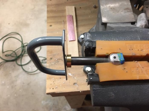

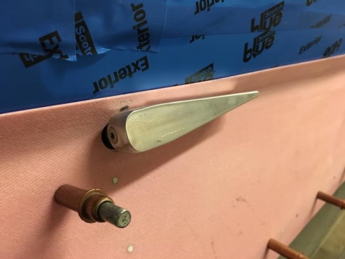

I worked on smoothing the outside handle then I measured for the screw that holds the outside handle to the inside latch pin. The hole is drilled, the hole is tapped to 8-32 and then the hole is countersunk for the screw.

drilled and ready for the tap
outside handle installed

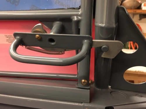

inside handle
inside handle
