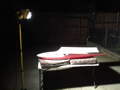

It was dark out by the time I was able to get out to the shop - and I really didn't want to dust the entire shop, so I set up a table in the driveway and put out my lights and grinded and sanded down the under flox. I was thinking that the under flox was causing a bit of interference with the canopy skirt when the canopy was closed, but it wasn't. I ended up taking off some of the glass over the canopy rail which was causing the interference - but I was wanting to redo the under flox anyway.
light and table set up on the driveway

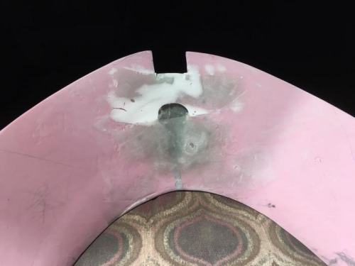

removed down to almost nothing

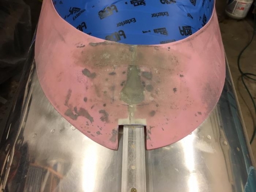

removed some over the canopy rail
