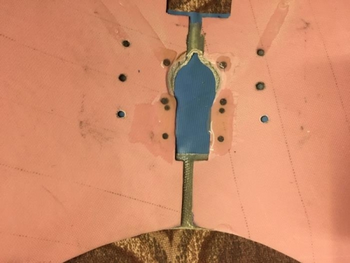

Most of the shop time was spent on iterations of installing the canopy skirt with clecos in every other hole, marking the positions of contact between the push/pull and the skirt, then removing the skirt to sand it from the inside. The push/pull is spring loaded and should return to "flush" with the canopy skirt - if I can get to that precision. The idea is that it just looks like part of the skirt until you push it. But to do that I need to remove all but just a little lip so that the push/pull will be flush.
After working on the flush fit for a while, I felt like I could get a better fit on the push / pull by moving the holes up a little. This would also change the fit because the push/pull would be on top of the skirt. Let's try. Before moving the holes (re-drilling them), I needed to fill in the old holes, as the current holes needed to move just a little. I didn’t want to mix a full pump of both resin and hardener, so I opted to use the T-88 adhesive to fill the holes. The T-88 is mixed at 0.83 : 1 and I ended up with much more than I needed – but it did the job.

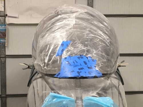

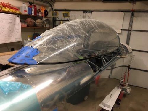

While I have the picture space - I will show you the method I use to install/remove the canopy skirt by myself - since I work alone most of the time. I clamp a tongue depressor to the front of each side of the canopy frame (wings). This allows me to set the canopy skirt in place and then I can cleco it in place while it sits there. If not, the long and gangly (u-shaped) canopy skirt is impossible to install/remove by yourself becasue it will just fall down on one side while you work on the other side - and it might break.
