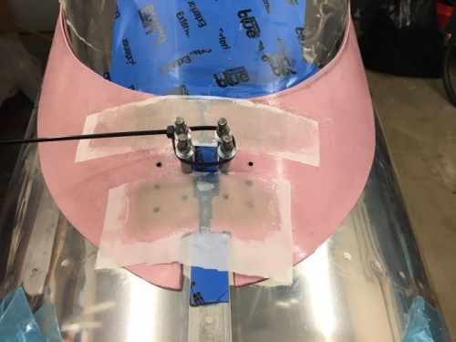

Brief Description:  Bonding canopy skirt sides
I got to the point where I was comfortable bonding the left and right sides of the canopy skirt. I have the aft gaps to a minimum and although the bottom horizontal gaps could use some work, I feel like I can do some of that gap work with the skirt on the frame...so let's do it - break out the resin and the fabric. I cut 6 strips of glass fabric, three for the top section and another three for the bottom section. I have to leave the gap in the middle for now.
