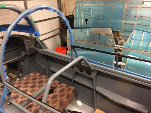

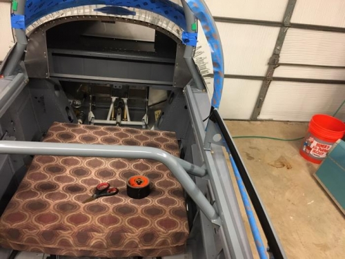

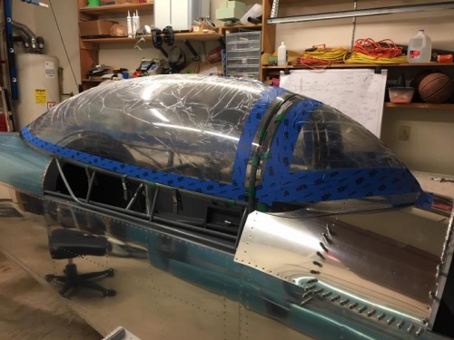

Brief Description:  Taping the canopy & frame for glue prep
I did some re-taping so as to protect the canopy from the primer and the glue. I also took the opportunity to put the windscreen on and check the fit and transition to the canopy. It looks good.
I then pulled the canopy off the frame, removed the spacers and cleaned the frame. I started taping off the frame in order to keep the primer and glue off of the places I don't need it. I will put another layer of tape on for a cosmetic line - which was a hint from my buddy Steve! I also checked in with Steve for some more glue technique feedback as I want to make sure I have the process down in my head before starting the glue clock.
black tape and blue
black tape and blue
