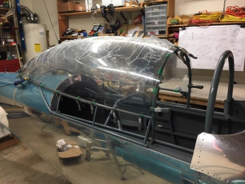

Brief Description:  Last bit of cutting on canopy - prepping for Glue

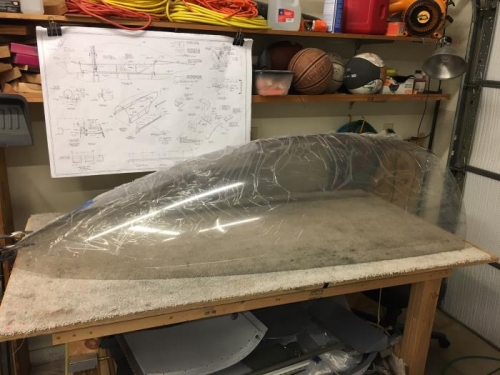

I strapped the canopy back on the canopy frame and took one more good look at the fit. I decided that I could even up the front a bit so I marked a popsicle stick at the narrow point and then drew lines at the mark for the less then narrow points of the front of the canopy to even things up a bit. I then laid down some painters tape along the marks and then marked the excess in red sharpie and took the excess off.
I took this time to go over the perimeter of the canopy cuts and went over the entire perimeter with #400 sandpaper smoothing the perimeter to a glass finish.

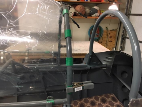

I then took off the tape in preparation for the glue and clamped the canopy back on the frame .
