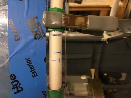

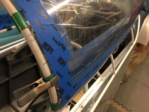

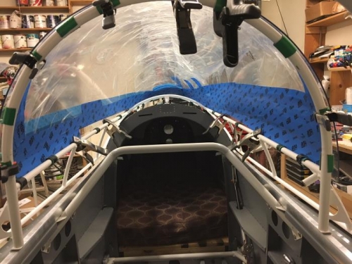

More cutting - this time on the left side. On both sides of the canopy, the forward 2/3 are very close to the final cut, while the aft 1/3 on each side still needs two or three cuts.
After cutting and sanding, I placed the canopy back on the frame and was able to clamp it right back in the almost perfect spot - I guess it's because I have had so much practice.
I am thinking that when I get the perimeter cut to the right fit - it will only go on one way - so it should be easier to place. The sikaflex adhesive that I will be using needs a primer that will most likely remove my alignment marks so I will have to think thru that step too.
